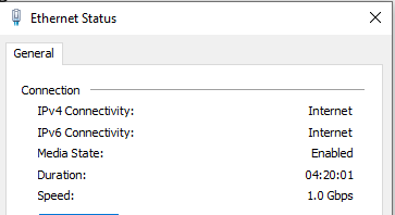

 Can you do a quick check to see the link speed of your ethernet adapter please?
The fact you're topping out at 94 leads me to believe your adapter is only running at 100 mb/s or the device in question does not have a gigabit lan adapter.
If you're on Windows 10 -
Right click the ethernet icon in the bottom corner
Click on "Open Network & Internet Settings"
Click on "Change Adapter options"
Right click on your Ethernet adapter and click on "Status"
If you see the following then your PC should be able to receive the full 900 mb/s .
If it says 100 mb/s then either your ethernet adapter is incorrectly configured, doesn't support gigabit or your ethernet cable may be bad.
In response to "You should get up to 900mb on a fast PC with a 1Gb Ethernet connection"
Any PC with a gigabit capable lan adapter and a decent quality 5e+ cable will get it.
