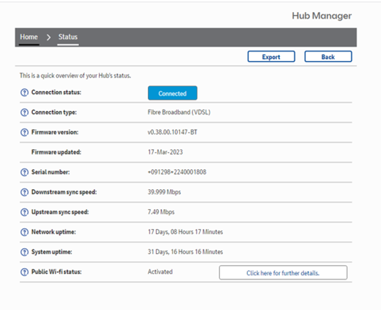

Hi
I rejoined BT from Sky in March with Fibre 1 and my download speed is capped at 39,999 (37,000 at the hub), despite my being able to get up to 48,500 in an ideal world.  Sky was capped at 40/10 but when I was with BT previously I was able to get up to 42,000 at the hub, and this was three years ago.
Surely BT should have put me on the 55/20 network as this is what I am paying for?
Thanks
Martin

What is your max attainable speed in the router? It's under Advanced settings > Technical log > Maximum data rate.
In fact, if you can share a screenshot of the page for the broadband gurus to review.

Thanks for your replies.  Here are the details from the technical log:
Product code:Hub
Serial number:+091298+2240001808
Firmware version:v0.38.00.10147-BT
Firmware updated:Fri Mar 17 00:30:54 2023
Board version:R01
GUI version:1.77 20_05_2022
DSL uptime:17 days,09 Hours33 Mins08 Secs
Data rate:7.49 Mbps / 39.999 Mbps
Maximum data rate:7.490 Mbps / 43.776 Mbps
Full Fibre (FTTP) Mode:On
Noise margin:5.5 / 4.4
Line attenuation:10.1 / 23.8
Signal attenuation:10.1 / 24.2
VLAN id:101
Upstream error control:Off
Downstream error control:Off

Are you sure you're on FTTC? you have Full Fibre mode enabled
Full fibre mode is enabled by default on the smart hub 2, it works fine with FTTC or FTTP, the only time it's an issue is if you're a BTTV customer, then the mode needs changed.
Turning that off would just free up a port on the back wouldn't it?
The users initial posts says only FTTP On Demand available at their location so it must be FTTC? No FTTP here either but the Smart Hub 2 seems to ship with that setting turned on for all.

Hi. Yes, at least that's what I thought / been told / signed up for  FTTP is not yet enabled in our road. Cables were laid during lockdown but we're still waiting. I've heard that it may be rolled out within a couple of months.  When I check what's available, I only get the option of FTTC. In fact, this is confirmed in the BT Checker image in my first post.
