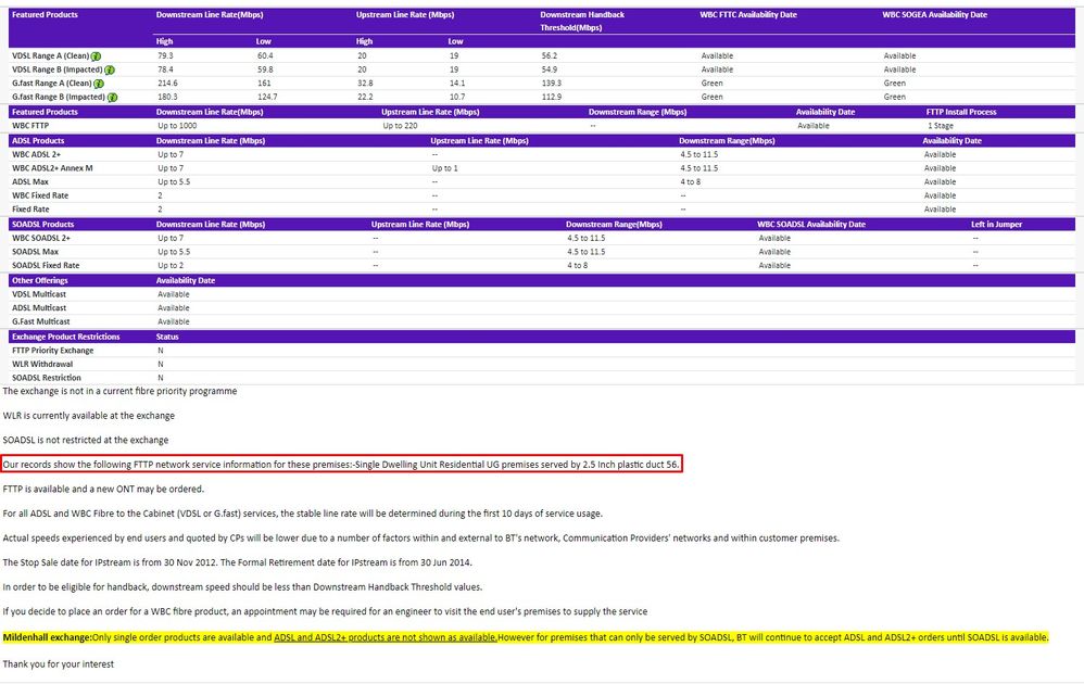

Could you paste the results of the page below specifically near the bottom it should state survey UG stage 2 etc..
Please remember to edit and personal info out however

Our records show the following FTTP network service information for these premises:-Single Dwelling Unit Residential UG premises served by 2.5 Inch plastic duct 56.

Reads positive actually 1 stage install (i.e. single visit) and I must say you are really spoilt for connection choices from BT Wholesale 🙂
So they'll likely use the existing duct with a draw rope to thread the external fibre install the ext junction box drill through or pass the internal fibre using existing wall conduit and mount next to current master socket location unless otherwise agreed.
