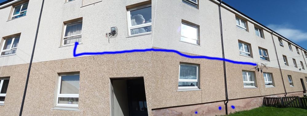

All these f lats have that outside cladding put in. Like special insulation. Now the housing association basically says if u damage it they want £40k or something. Now the BT engineer needs to drill holes into the bricks below the cladding for some reason and run the cable from the black box at the bck of the building to my window and drill through (the  cladding). My housing officer needs t oknow exactly what the engineer needs to do and i have no idea how to ask them so my officer can give permissiom

Unfortunately its not a landlord so much as social housing and they're absolutely horrendous. I've spoken on phone and i think i understand what needs done. The old housing officer didnt want the cladding damaged (he seems to think theyre works of art or something) but newer officer was being talked  round. I'll see how i get on. Attached pics of what is needing done . I think he's more on board with BT because the box is at the back of the building whereas Virgin is at the front.

Forget the black box that is for copper connections. A new fibre cable from the pole (possibly to the same bracket the copper wire uses) down to the ground floor where it will terminate at the CSP ( a small box for the fibre splice).
An ONT (modem) will be fitted internally in your flat, hole for fibre cable drill to outside, the cable would be clipped around to the CSP, cut to leangth and spliced. That is basically it.

Oh right the engineer was talking about running a cable from that box so dunno. Yeh it doesnt seem like an unreasonable request like. Its just the drilling into my flat theyll prob have an issue with but all the flats are like  this and a lot of people are just lying to the engineers and saying they have permission so sure its a matter of time before they have to conceed

If the can’t attach cabling to the cladding then they’ll have to look at an MDU type build and run it internally.
