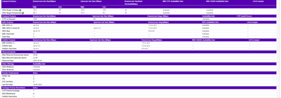

Hi - my line was previously "locked" at 55Mbps by an engineer and was like that for over 5 years. Recently renewed my contract and this has dropped to following. How can I get my line reset so I can get back up to or over the previous 55Mbps? Thanks for any help you can provide

According to dslchecker results you had an up speed of 15.94 in April but same down speed hence why I ask about your urgent package.  It is possible that you were on fibre 1 and a few years ago got a free upgrade to fibre 2 speeds if possible.

as attainable is only 59mb you are better fibre 1 with 55/10mb
