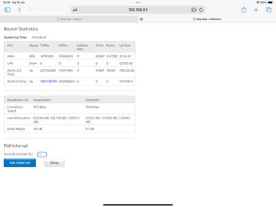

Hi so am after some advice.  I have FTTC and the cabinet is about 1500m from my home.  when it was first offered i was getting speeds upto 20Mbps.  Since then  (in my opinion) the quality of the copper connection from the cabinet to my house has deteriorated and my avg max speed is now 12Mbps.  However previous bband provider sky refused to accept fault and reduced my guaranteed minimum speed to 7Mbps and ultimately offered to let me leave my contract after it repeatedly dropped below 3Mbps.  So i am back at BT the line speed hasnt changed (unsurprisingly).  Any ideas how i can get someone to investigate quality of the copper connections and reliability of my connections?sky bb.jpg

Those stats show a download speed of less than 1Mbps and a very high noise margin indicating a line fault.
If you still have an analogue landline, check for a noisy line. If it is noisy, report the fault as phone fault rather than broadband.

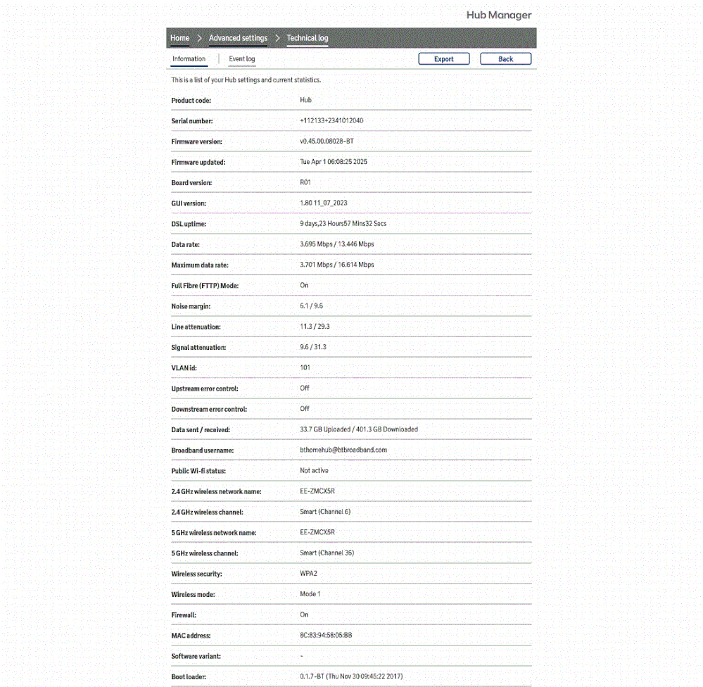

Advanced settings> technical log > information

from the stats you are currently getting 13.5mb down and 3.7mb up and you connection has been stable for virtually 10 days  your max attainable is 16.5mbdown and 3.7mb up and your noise margin is at 9.6db .  provided no line noise your noise margin should drop to about 6db which will increase down speed to nearer attainable

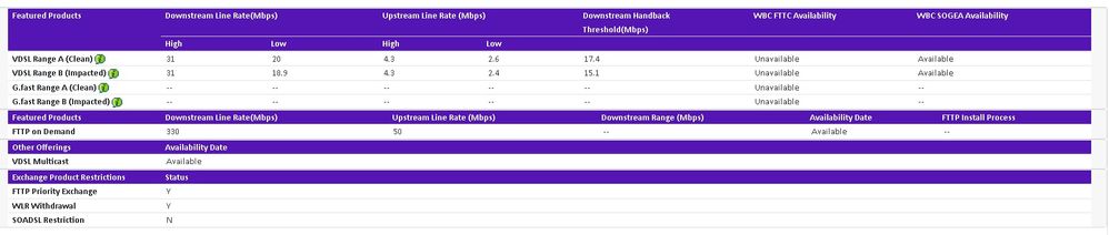

can you enter address and post results including notes   https://www.broadbandchecker.btwholesale.com/#/ADSL/AddressHome

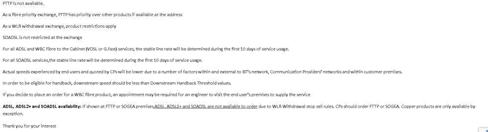

attached below
