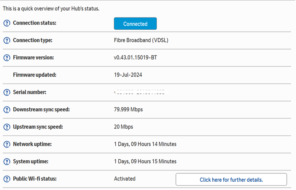

Issue I am having is, I used to have a 75Mbps downstream and 19Mbps upstream. I was investigating an issue with an online game and noticed that now, the speeds are 53Mbps downstream and 20Mbps upstream.
Connection to hub is great. I do not know when this drop has occurred exactly. (I was checking speeds when BT contract was due for renewal 11th July 2024) Connection has been constant 70+Mbps downstream and 17+Mbps upstream for many years, with a few minor issues.

Your hub is apparently still giving you almost 80Mbps download speed, so the drop to 53Mbps must be occuring within your local systems. Not sure what you mean with "connection to the hub is great". Is the 54Mbps download measured for a WiFi connection or an ethernet cable one?

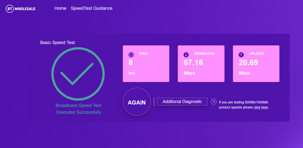

Before new cableBefore new cable

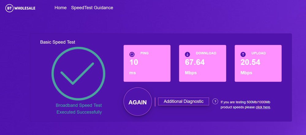

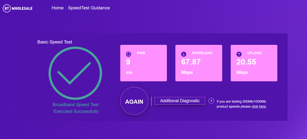

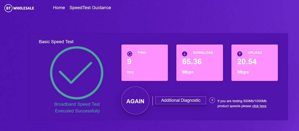

New cable  PORT 1New cable PORT 1New cable PORT 2New cable PORT 2New cable PORT 3New cable PORT 3
I am so confused, downstream went up to 65Mbps. Tested before (Internal cabling) and after with new 30m cable. If the speed decrease was internal cabling, then there would be a difference in speed.
