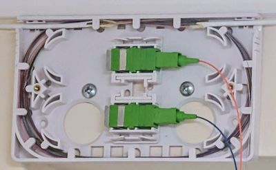

Not sure you'll be able to get much from this. This what was being installed at the time and managed to get a picture. Now just a blanking plate over the top with a little laser sign.
It runs down the flat and then into the locked cabinets, so can't see what's on that end sadly.

I know Openreach use Double and Quadruple Port Breakout Boxes for External Build but internally the Breakout Boxes have always been Single Port and every flat gets their own, not one between 2.

From what I’m understanding this Company basically installs part of the Internal Network, in this case the Invisilite Fibre Cable, Breakout Boxes and most likely some kind of Basement Box and or Internal Type Splitter with the Intention of a Network Provider connecting their main cable feed and I assume ONT’s to it and I assume they will have to rent the use of the Internal Breakout Boxes.
If that’s the case I can categorically confirm Openreach would 100% not do that and would want to install their own Internal Splitter/Basement Box, Invislite Cable and Breakout Boxes.
To me it sounds like your MDU Owner/Management Company is trying to make money off it themselves as I bet they’ll want their piece of that Rental Money for the pre-installed Equipment.
As said, Openreach would never go for that and I seriously doubt the likes of CF and VM would either. Maybe one of the smaller more local Alt Nets but then you’d be restricted to using them and them alone so they can Jack up the price as much as they want because they aren’t regulated heavily like Openreach and can pretty much charge what they like.
