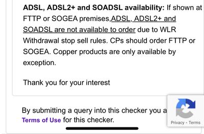

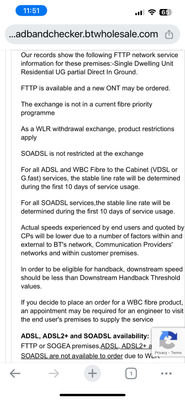

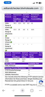

can you enter your daughter's address and post results including all the notes which will show what is available and if dig is needed
https://www.broadbandchecker.btwholesale.com/#/ADSL/AddressHome

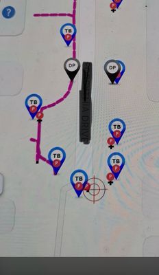

If this DP is too far on this side of road could they not use the DP and fibre that extends closer to their property on other side which is a culdesac  and the house is at the end
See the photos we were provided with ?

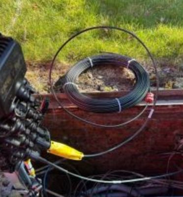

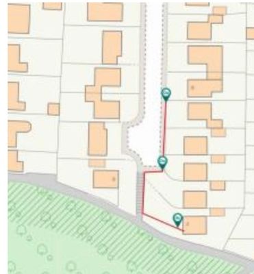

Surveyors report :-
“Buried estate new duct required from house around edge of driveway 28 in soft and and then to box 25m hard marked up with grey paint cable coiled up at CBT”
this is the surveyors photo of the coiled cable he mentioned
could openreach access the premesis from the opposite side of the street as shown below ?
