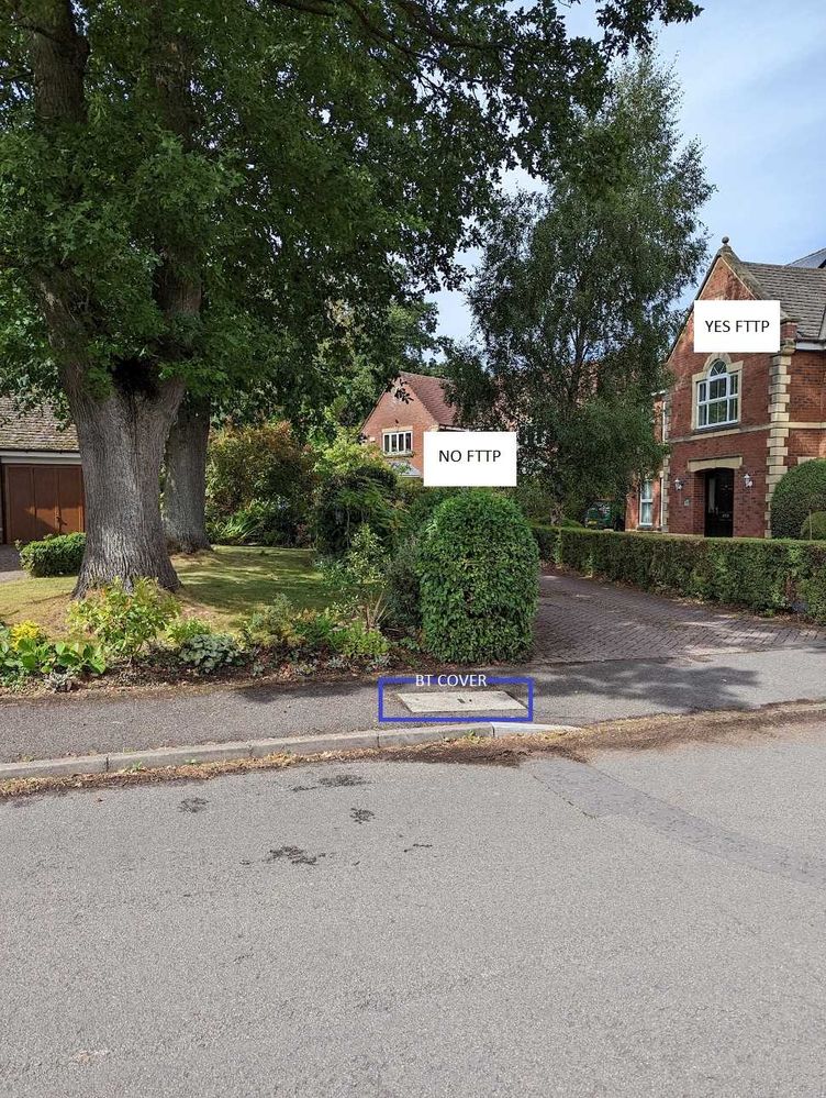

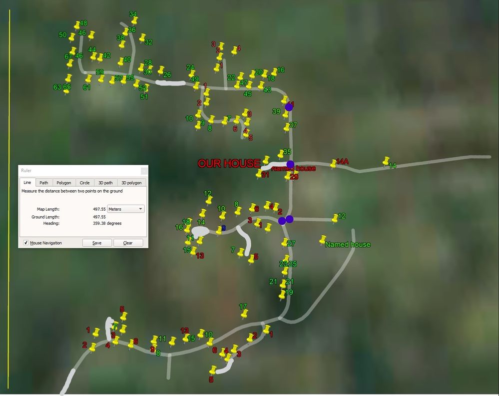

Not planning to lift the covers but I've updated my map with nearby covers and a photo showing proximity to cover/FTTP house.
All houses were built in 2000

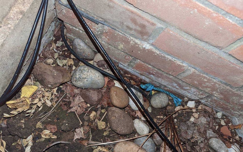

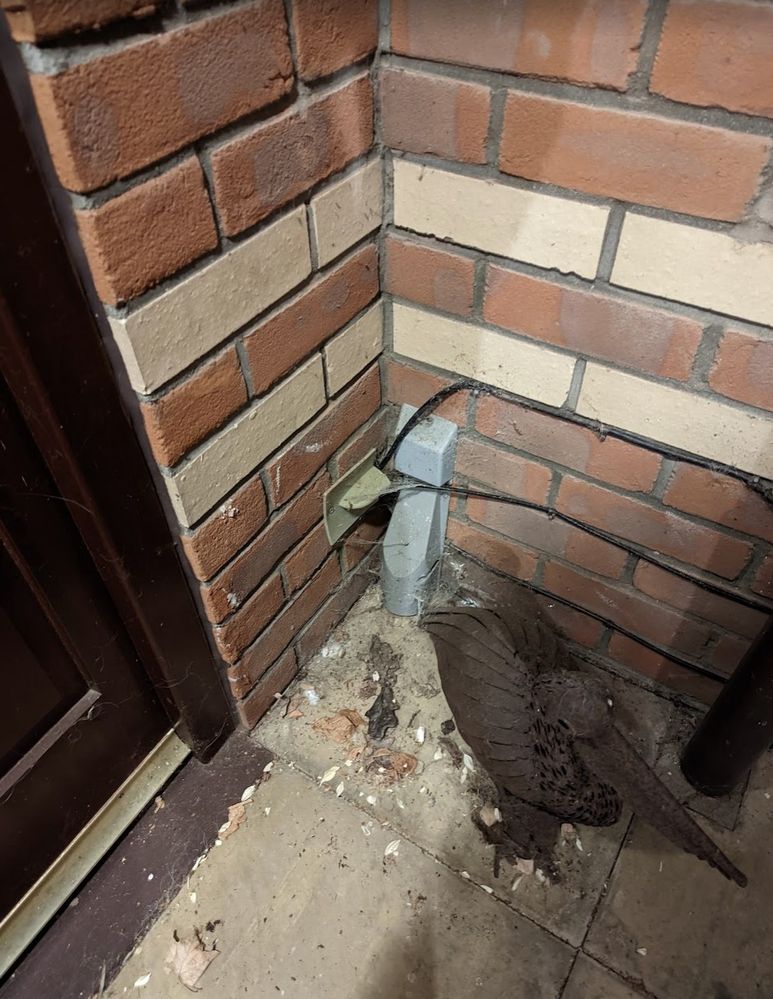

The image of the duct mouth at your house wall is missing some Openreach ‘covers’ that normally protect the cable until it enters through the house wall ( a BT connector bend 4a ,BT  capping 25 and BT cover 101a ) they also provide a neat finished look , if these were always missing ( rather than removed when the duct was roped ) and the duct mouth was covered with garden material ( soil, grass etc ) the survey may have indicated not that the duct wasn’t verified,but didn’t exist ,  but then the survey for the neighbour states UG duct not verified, and they got service ,  so in itself shouldn’t  omit your house from the build.
Often in locations such as this , there is a single duct leaving the joint box , ( rather than an individual duct to each property ) the duct effectively runs to a ‘duct tee’ where one ‘leg’ of the tee goes to the first house , and the second leg runs to another house , or another duct tee , if a duct tee were damaged and a new cable couldn’t be run through it,  it likely would be located in someone else’s ‘land ‘ and excavation would be needed in that other persons land to repair/replace it requiring that person’s permission ( which wouldn’t necessarily be granted)  , however the fact that your duct is roped suggests that the duct to your house  is serviceable….
The access road is to your property and neighbours is block paved , it’s probably not adopted by the council ( they wouldn’t necessarily want to take responsibility for this type of surface, and OR wouldn’t have automatic rights to excavate in it , as they would with the conventional footpath the jointbox is located , perhaps this has some bearing on you not being able to order , the route to your home effectively running through private property.
It does really seem to me ( on the face of it ) you should be able to order FTTP and it’s only going to be a data error , or some ‘record’ that is missing or inaccurate that is stopping your address showing as being ready for service , but as you have found , it’s not easy to speak to anyone in OR ‘planning’ about it.
As already stated, I would try the executive level complaint route ( an email to the CEO can start this particular ball rolling ) , you likely would get a phone call from them , and they have the option to speak to OR planning to get a full explanation and pass that information onto you
You have already indicated that you won’t be peeking inside that jointbox ( looking for the other end of that blue rope and if a CBT exists  ) if you could get an OR visit to do just this it would provide confirmation one way or the other.

We do actually have some covering (photos below), the cable runs from the duct to beneath our paving and then comes up in a cover (surrounded by my own mess of ethernet cables).
I'm really hoping the rope already being passed through our duct will mean they are able to pass cable through without excavation which I assume they wouldn't do. There are several of these brick pathways to multiple houses and they've received FTTP so hopeful it's not an issue.
I used to do surveying with a touch of utils and we were never allowed to lift the BT lids, so think it's drilled into me 😅 May have a peek tomorrow (especially if this Twitter attempt goes nowhere) and grab a photo to share here as I surely won't know what I'm looking for.
