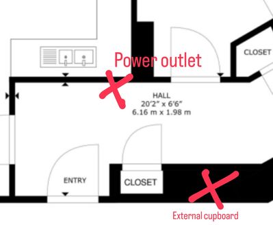

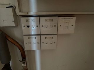

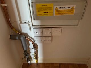

Hi, I just moved into my new flat and realised that there are no power plugs where I thought they would install the ONT. The CSP is in a cupboard in the hallway of the building, which is adjacent to a cupboard inside my flat, where there is the BT master socket, an Hyperoptic socket, the fuse box, and some numbered RJ45 phone sockets which have its correspondent ones in each room of the flat.
I was planning on having the ONT installed in the cupboard, but realised that there are no power outlets in the cupboard.
The nearest power outlet is on the other side of the corridor, and next to it there are also 2 numbered phone sockets. Do you think the Openreach engineer would run the fibre cable through the conduit that connects the numbered phone sockets? Not sure is the bends would be ok for the fibre cable though.

Bit confused by the wording of your Post as I think it implies you have an ONT Installed, although I don’t see one in the photos.
Or are you just assuming they’d install it by the existing NTE when you do get one installed?
If there isn’t one then they’d just run the cabling to where it’s needed anyway.
Is that CAT5e Cabling actually in a conduit behind the plaster board, can you see if it you take the front of the socket off?

I don’t have the ONT yet, and yes I assumed they would install it next to the NTE, but there are no power outlets nearby.
Ideally they could install it where the power sockets are (on the other side of the hallway), running the fibre through the existing conduit, but not sure if the engineers would do it.

I wouldn’t be able to run en extension lead, it would either have to cross the hallway, or run around the doors needing around 10m of cabling. It would be easier to install a power outlet in the cupboard, but I would need to get an electrician before the Openreach engineer, which I see unlikely.

I hope I would find an electrician quickly, I believe that installing a power plug would take less than 30 minutes? In the cupboard there is the fuse box and a light switch, not sure where it would be best to take the power from.
