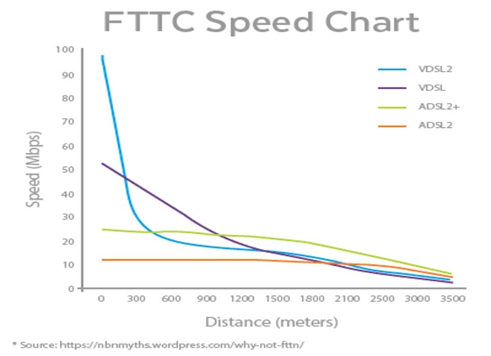

Re: Ongoing Broadband Fault
8Mb/s would suggest a couple of Km away.  The graph shows what I mean.  (Images go into quarantine until a moderator releases them, so you won't be able to see it for a while).

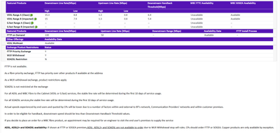

Hi, I had to restart my Hub again, to be able to do this. I have another engineer booked. If you could tell me what this all means it would be very helpful. Thank you

that confirms you are a long way from your cabinet as estimate speed is between  15.3/8.8mb down and 1.3/0.8 mb up.  there is no full fibre available - fibre on demand is not the same and expensive for business
there is no date given when area is expected to get full fibre

Your estimate of the distance to the cabinet is way off , the speed you get is appropriate for a distance around 2500 m to 3500 m from the cabinet (not half a mile or around 800 m ) , in the past ,  at this distance from the cabinet, exchange based ADSL would perform better than FTTC  , but that’s no longer on offer especially as you have a telephone service associated with your broadband service , if you were moved from ADSL to FTTC (because of the PSTN switch off ) and your problems coincided with this , then it may be that your FTTC is effectively working at its limits , that unfortunately is just physics, there is a point where the service just can’t work reliably.
To give any real help ( using real data ) you really need to post your router connection statistics, preferably twice , once when performance is poor , then again just after you have reset the router and performance has improved, without this then this thread is somewhat pointless , you have a service you are disappointed in , the provider has offered you the option to leave penalty free , but you presumably are not going to take that option, your provider has (on the face of it ) explored every avenue to improve service , all replaceable items have been replaced , your home checked (even though arguably this isn’t your provider responsibility) and Openreach have visited multiple times .
