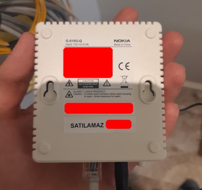

Hi @Rob33   I don't know what I am talking about, but doesn't the whole thing simply unhook from the wall by moving it upwards? Obviously, be very careful with the cables.

A wall mounted ONT , like the one shown in the supplied link (so not inside an enclosure) , as stated can be manoeuvred off its location screws by gently pushing it upwards ( 0.5cm ) then forward from the wall , obviously taking care with the optical cable , refitting the same process in reverse.

Yep - that worked - came off as one whole unit and left the 2 screws in the wall ready to hook it back onto. No need to disconnect any cables or even turn off the power. There is no front cover to remove.

Fibre cable comes in the bottom - whole units slides up off the screws as in answer above - and enough slack to strip off old paper and do the new paper.
