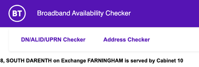

My property is covered by the Farningham Exchange (cabinet 10), but they're incorrectly routing to the Dartford exchange (cabinet 12), meaning the engineer can't connect anything.

what does it show if you use your phone number - options available.
if it's not to improve your broadband then what difference does it make which cabinet your are connected to?

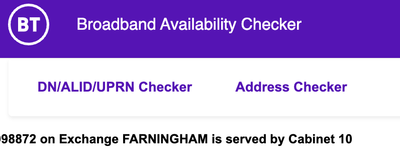

Hi, you can use a UPRN number instead
To fins yours, head to https://www.findmyaddress.co.uk/search and enter your postcode and select your house number
You will then see a long number starting 1000
Enter this number into the checker and you will see the results of your house

Says the same thing. Farningham Cabinet 10. Not Dartford Cabinet 12..
