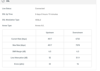

I've noticed over last few weeks that my internet connection has randomly reset and router was reporting some connection errors.
Today it's extremely slow and wonder if I've been put into a banded profile because of the errors or if the line has just broken down even further?
I did hard reset the router once and double check everything such as username entered correctly etc etc. It reconnected at the same low speed. Think my package is Fibre 2 (if it's still called that) and usually maintains solid 8MB/s.  Pic from router settings attached. Haven't altered any wiring in the house but wonder if water getting in somewhere outside as seems to have happened each time there was heavy rain.  Already reporting errors even at slow speed.

Nothing wrong with those stats, SNRm is normal at 6.3dB and speed  close to your normal 8Mbps at 6.7Mbps

Really. Upload speed is nowhere near what it should be.  This is why I wondered if I'm on a banded profile because I'm not getting anywhere near those speeds.

Unfortunately you are starting from a very low base in the first place. 8Mbps is extremely slow, but you are still getting 6.7Mbps. It is possible that DLM has intervened to increase your noise margin to 6dB (the standard margin) rather than possibly 3dB that a very stable line can achieve.  Your upload speed is 4.5Mbps
