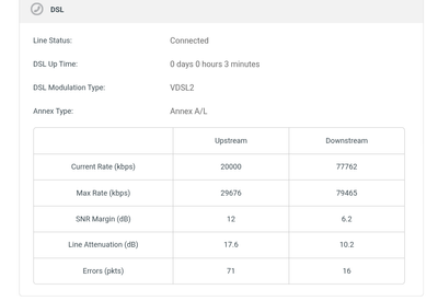

Just an update on this. Found a filter in the cupboard and things lot better using test socket.
Router stats are:
So does this mean problem is with my internal wiring or faceplate on master socket or something else.  Tempted to just leave it stuck into test socket.

Yep, the problem lies within your internal wiring or the master socket. If the fronplate of your master socket just clips on rather than screwed it is often the source of the problem. Try  replacing the front plate and see if simply removing and replacing it has resolved the problem. Otherwise there is no problem with leaving your router connected to the test socket other than the aesthetics.

If you look at your non BT router stats before the ‘fix’ and after  (that in itself is a reason why support may be somewhat lacking , if you chose to use your own router rather that the BT supplied one, BT only supports their own equipment ) ..your line attenuation was massive when you first posted the router stats (50+dB ) and now around 10bB , so you obviously fixed the issue yourself.
