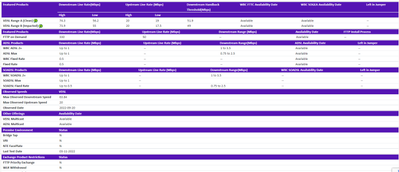

Hi All,
Here are my figures for my line, hopefully you can make some sense of it and I call BT with your recomendations.
6,287 Views
Message 6 of 20
Re: Broadband speed is now throttled to 20mbs compared 38mbps to when it was first installed.
Your estimated range is 56-74mbps, as you are within that range there's not a lot BT can do.
On the20th Sept your observed download was about 64Mb, roughly in the middle of your predicted range , so from that perspective there isn’t anything obviously wrong , post your router stats , they may indicate something , but 64Mb download could equate to something like 68-70Mb sync rate.
