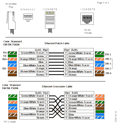

I crimped the connectors myself. All 8 cores, straight through connections and cat 5e cable  UTP  solid cores 24awg.
6,110 Views
Message 4 of 11
Re: FTTP red end cat 5 question
Go to solution
Did you wire the pairs correctly?
Try crossover rather than straight.

Did you check the cable you made with an Ethernet Cable Tester to ensure that they are all  correct and securely crimped.
6,079 Views
Message 7 of 11
Go to solution
Yep crimped all okay. The only difference between the red ended cable an my cable is that my cable is 24awg and BT's cable is 26 awg.
6,060 Views

I can't see it being the length of the cable, I have a 20M CAT 5e cable going from the ONT to the router with no issues getting a 1000Mbps connection.
Have you got a cable tester, looks like one of the crimps hasn't worked if it drops to 100Mbps
