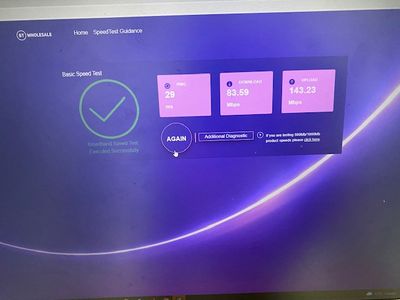

The issue is as follows - I am paying for Bt 900 but when I run hard to wired tests in the house - I get 80mb , 60mb , 120 , 150. I have done all the tests with single Device and also the laptops which the engineers bring and used  fast website and also bt whole sale website ... the speeds are always consistent and always poor compared to what I should be getting ......no where need the expected speeds !!!

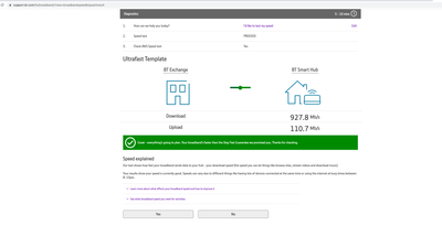

You can see your connection speed to the hub from ‘My BT’ , any third party speed tester is only a guide to throughput  , if using them , you need to use several and several times to get any usable measure, perhaps you can post some results as well as the MY BT check.

i executed a speed test from my BT app and they say the following but i am uncertain this is true hence why i want to test it myself :
i did additional hard wired tests (not wifi ) to the router via bt whole sale  attached the results below so am not sure what else i can do to verify ? Again any help most welcome to get a true test

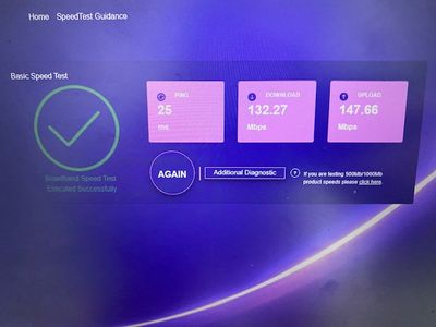

and running tests as a result:
bt whole sale test when connected to the ONT with pppoe connection was the same -....
so does this confirm there IS an issue with the speed coming into the house and that BT are wrong in the saying there is no issue and that its a device issue??? i just cannot get my head around what i have to do to explain the issue to - -- HELP!
