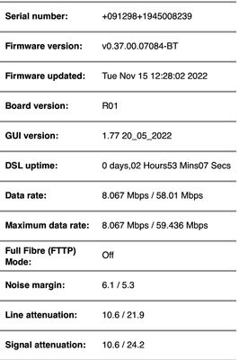

Can you post your Home Hub router stats and we'll take a look? You'll get them by entering 192.168.1.254 in your browser, go to advanced settings then technical log information.

4,357 Views
Message 5 of 14
Re: Really poor broadband connection
Hi @roco1970 thanks for getting back to me, the router stats look ok apart from the uptime, did you restart the Hub or did that happen on its own?
If rain is affecting the connection it would be worth getting Openreach back to check it out. I'll send you a private message so you can send over your details to the moderation team and we'll be happy to help.
Thanks
Neil

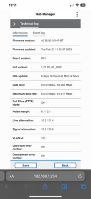

can you post hub stats like before be good for comparison and illustrate your problem

Message 9 of 14
Hi @roco1970 I'd also recommend doing a quiet line test by dialling 17070 to see if there's any issue with noise on the line.
