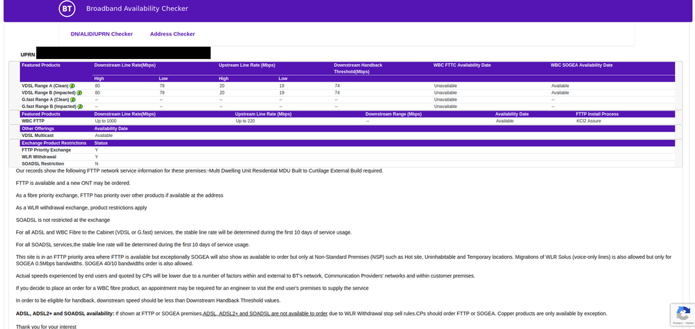

We're looking into ordering full fibre in our rented property. CityFibre was here some time ago drilling up right outside our door on the public footpath and around the general area - at first we thought we could only order with them, but now the fibre network is (seemingly) also available with OpenReach.
I used our UPRN to look into things before we ask permission from the Landlord but given we're in a MDU surely it's going to be a no go? I noticed it says "Multi Dwelling Unit Residential MDU Built to Curtilage External Build required" - which I assume would mean digging something up to connect with the fibre underneath the footpath? I hope it would be a simple installation, but the wholesale checker doesn't have me convinced. We have a small path to our door (which has a hedge and gravel which surrounds the whole building) which I am certain is owned by the company who manages the building, not the Landlord. We're on the ground floor if that helps. And currently we are on VDSL (I believe)
The results of the checker:

To also note that your in a FTTP priority exchange area which means providers that use Openreach will only be able to provide your with FTTP anyway for new contracts and contract renewals as FTTP it's available to order for your address.
More about Openreach's copper stop sell and FTTP priority exchanges: https://www.openreach.com/fibre-broadband/retiring-the-copper-network

The survey network note (SNN) for MDU’s is vague because there are many variations on a MDU , a 1960’s tower block , or a small building containing a couple of units ….medium and larger MDU in effect need to be built separately from the general FTTP rollout for that area , some smaller MDU can be thought of as SDU ( single dwelling unit ) if they can be served in a regular way , for example if a small 4 unit block two ground floor flats two 1st floor and a pole exists , possibly already providing the copper pair services, then providing service for the top two is the same as a regular house ( possibly needing long ladders ) the ground floor potentials needing the flat above permission for the cable to attach to ‘their’ flat before running down the wall .
MDU that are currently served by  internal copper distribution, so a large single   copper cable  ( containing multiple pairs of wires ) enters the building underground to a distribution point and internal cables ( one per flat ) provide the individual connections ( this is normally what medium and large MDU have) , need ‘planning’ and permission from the appropriate stakeholders ( freeholder , managing agent , etc ) .
Without knowing the details of your MDU it’s impossible to know what is required, but the order process must be different as Openreach can’t just  send out an installer , and obviously depending on the freeholder attitude etc.  it’s impossible to know the time frame
