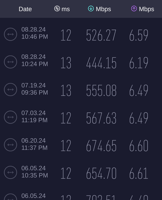

I have had BT FF 900 for around 4 months now and consistently get poor upload (and lower than guaranteed download). I would get anywhere from 20 - 30Mbps upload before when on BT fibre 100. It causes some serious issues when working and trying to file share and upload; main reason I upgraded was to speed up file transfers.
Both BT wholesale and Ookla give identical upload results but differ in download results. Any advice would be great as I was told over the phone that upload is what it is and there is nothing to be done, which I don't believe as upload has been better (but still not great) previously on a lower speed and price package.

This has been ongoing from day one 4 months ago and is nothing new and has been raised for a call back and enquiry 3 times now. On the first day when it should still have been switching over I was getting 930D/80U but after that it has been intermittent down with a best of 800+ Mbps and an average of 4-700Mbps but the upload has been 6Mbps throughout.
I have spoken to customer services before and after a 3 day wait for a call back where a very but clearly technically inexperienced person told me on that day my download was at the minimum guaranteed of 700Mbps (still poor IMHO and way below the average but I understand at or above the guarantee), and that they had no control over my upload 🤔; clearly incorrect as my upload has been far better at times in the past and on a lesser cap.  When on BT 100 my upload was 5x better than now. My upload is shocking and affects my work and also other things such as online gaming.
At 6Mbps I'm getting below my minimum speed and over 100Mbps less than my maximum. Way off my estimated. I may as well go back to copper and pay pennies.

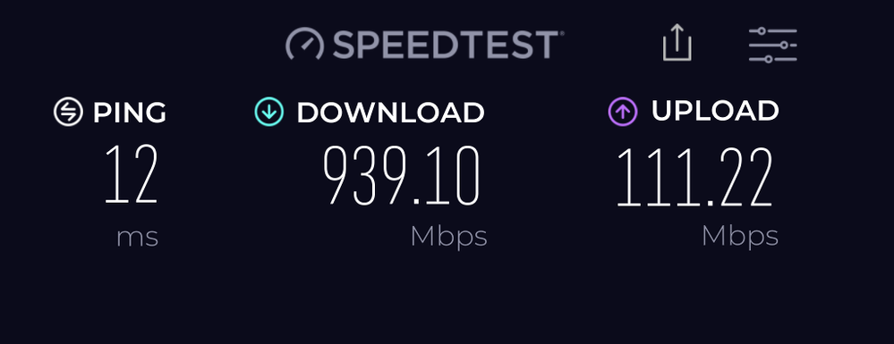

There have been a few problems posted about slow upload , and it’s not always the same issue , although occasionally a few things are done simultaneously so it’s never clear which particular thing was responsible for the poor performance, to start with the ( relatively ) easy things , you need a visit and for the tech  to replace the ONT and clean the  SC/APC ‘connector’   ( the green plug that connects to the ONT ) , if that doesn’t fix the issue , then realistically it’s a headend issue , although optically your connection is identical to every other connection on your splitter , so every user on the splitter would be experiencing the same issue ….l doubt it’s a provisioning issue but it’s may  be worth getting your service effectively ceased and then re providing to clear out any potential data corruption , unfortunately it does seem to require tenacity to get these issues sorted when the download is OK , and only upload is the problem

Just a reply to say thanks and all sorted. It was indeed an issue with the SC/APC ‘connector’.
A clean (carried out by a friend who had some optical/fibre cleaning equipment)Bt Speed test after cl.pngOokla Speed test after cl.png and now getting  very healthy results. So not my equipment but on my end. Any way, thanks for the advice
