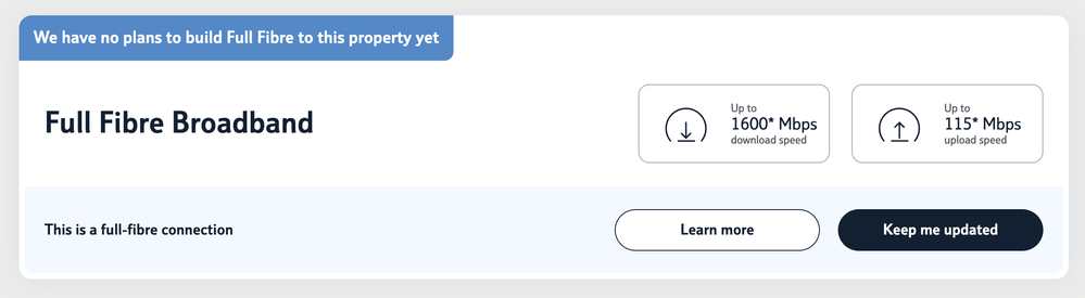

I am just about to complete a purchase of a new build / barn conversion on a small plot (no obligation for Openreach) where the developer was supposed to leave an Openreach connection.
The connection isn't showing up online, but BT has said over the phone they can provide a gigabit service. The developer is trying to confirm the address in teh Openreach database, although I don't think it will be done in time for teh house purchase. I'm a little reluctant to take BT's word over the phone that 'everything will be okay'. I may not have any choice.
I know the neighbouring properties (not the new builds) don't get full fibre. so is it realistic to expect I will. I know the developer has laid ducting and they say Openreach has made the connection, but I can't see an ONT at the property. I tried the Openreach website and got a very contradictory result (see below). 'No plans for your area' coupled with 'This is a full-fibre connection'.

If the developer went through the usual ‘new sites’ process with Openreach , then an ONT should already be fitted and ready for an ISP to arrange services before you get the keys …if no ONT exists it’s unlikely that the developer has done this new sites process , and although on sites of 19+ plots there is no cost  to the developer to get FTTP installed , there is a sliding scale of costs for 1 to 19 units , so one man band type developers often don’t  not engage in the new sites process , in situations like this whatever the existing network is , is what you would get but even that needs evidence that the property ‘exists’ as a proper dwelling, by being on the Royal Mail site and being registered with the local authority for council tax etc .
https://www.openreach.com/content/dam/openreach/openreach-dam-files/new-dam-(not-in-use-yet)/documen...
BT can only provide FTTP when Openreach /BT wholesale say it’s available, put your address in here (if it has a proper Royal Mail entry /registered address ) , it’s unlikely  that BT would say we can provide FTTP if there is no entry on this website for your exact address,  showing WBC FTTP  ,as it’s fundamentally the same data BT use to say Yes  or No ,
https://www.broadbandchecker.btwholesale.com/#/ADSL/AddressHome
Post the  entire return for  your address if it appears .

I tried the link you provided and the property address appears in the list (an improvement on the BT retail site where it doesn't show at all). However, when I click on it I get:
'We cannot determine broadband availability at this location. This may be a new address to which connectivity is not yet complete.'
The thing that's confusing me is there are a few neighbouring properties built a while ago. They cannot get full fibre because they only have FTTC (overhead copper wires). This makes me wonder whether I can really get gigabit. The developer says they have laid ducting in the new road and contracted Openreach (I'm yet to see proof of either and they are untrustworthy). The property is quite remote - maybe half a mile from a built up area.
If the developer is to be believed, I'm presuming Openreach would have needed to install overhead fibre across the fields from the nearest cabinet to the ducting point for the new builds / telegraph pole with copper for the other properties.
There's no ONT. In fact, if I don't get this connection, I won't have any comms and I'm worrying about a huge expense to me if the developer can't be trusted. Exchange is in the next couple of days. There's no point trying to add contractual penalties with the developer. They will be gone.
I'm going to have to decide whether I can trust the telephone conversation I've now had twice with BT. I'm hoping if they take the contract they'll have to honour it, regardless of what they might find when they arrive. They say the property is on the 'silver list', which is why I can't see it at bt.com.

TBH , you seem to want to believe FTTP is available and that even if it’s not you will have some sort of obligation on BT to provide it …the evidence is pretty strong , FTTP isn’t available, what’s more I recon if you tried  , and BT mistakenly took your order for FTTP it would simply be cancelled by Openreach , no compensation would be due (explanation follows)
Your assumption as to what will take place to get you served is not really accurate, if the general area is overhead service, it doesn’t really matter if the developer as obtained some duct from somewhere (it’s easily obtained ) and ran it to the curtilage of the site from the dwelling , hopeful that Openreach would somehow connect it up , thats not really likely and TBH it’s pretty clear they haven’t contacted Openreach , probably because of the contribution they would be required to make towards FTTP on a small (19 dwellings or less  ) development , that’s why I provided a copy of the rate card so you could see the kind of costs the developer has (you know the number of plots I don’t )
What will almost certainly happen , if you manage to get an order raised in the first place  , as a silver address is one that fails the address matching process , a non contractual date is given , this is really a ‘Openreach will come and have a look , no promises’ type visit , the property surveyed and if possible to provide from existing infrastructure that is put in place (a wire from a pole that exists) if extra infrastructure is needed depending on costs and complexity (if for example a third party wayleave is needed as private property needs to be accessed) that’s examined as far as practical with the potential of excess construction costs to be raised that you pay should the costs exceed a set limit .
