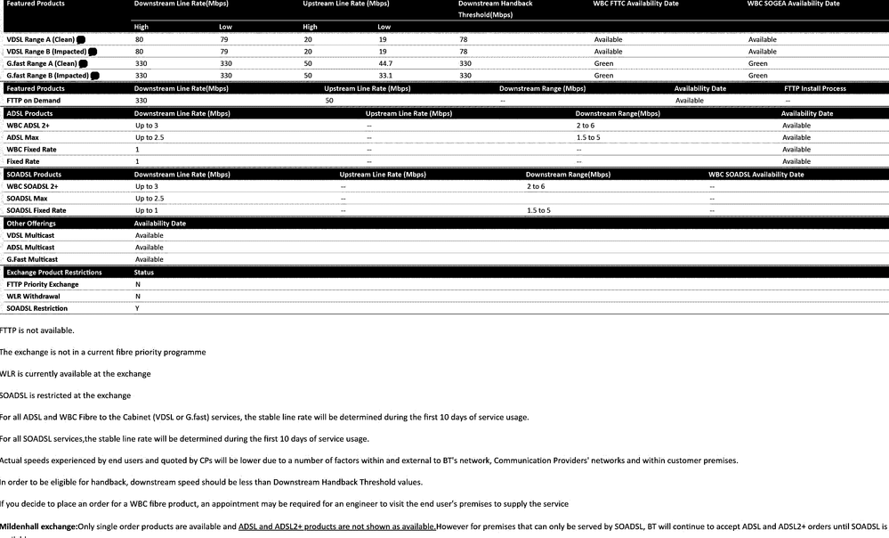

If you're not sure which you'll have then go to https://www.broadbandchecker.btwholesale.com/#/ADSL/AddressHome and post the results for your address (retract the address before posting)

Here are the results for my address:

@dystuk
So yes it will be FTTC based meaning your existing copper line will be used between the property and the cabinet
