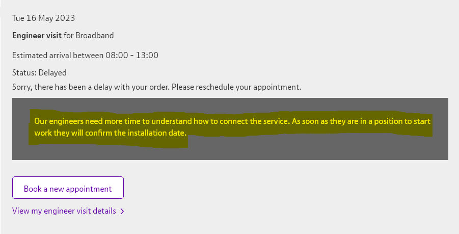

On 16th as promised, cable was laid, my ONT was powered up, but just a blinking green light. The installation engineer said the cable is all okay up until the box on the street where it is terminated and BT has to fix it.   When I called BT they say it is with OR network team who will assign an engineer in 5 days who will then decide when to do the work. Asked BT if they could escalate it within OR and the person seemed annoyed but said he will. Up until today no further information 7 days later.😩
But I saw this on the Track order in my account. Funny ! Not sure what the issue really is..😞BT_Funny.png
