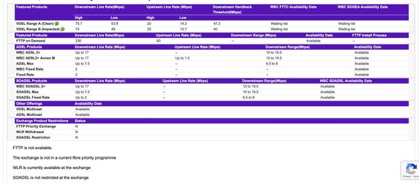

Enter your full address in the checker and post a screenshot of the result. Edit out your address before posting but leave all other information.

You've cut off the right hand part of the screen where the interesting bit is shown. For VDSL, does it say available or (as I suspect) waiting list?

Sorry, What a Div!!

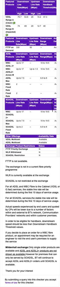

Some columns are missing from the right hand side in particular “Availability”. Can you please show the complete chart?
Sorry late as usual

Yep, there you go. There are no spare ports left in the cabinet, that's why you can't get a faster speed with BT. The other ISPs appear not check whether there are any spare ports and blindly offer what is not available.
If you switch provider, you will lose the port you are currently using and there is no guarantee that you will get it back if somebody else jumps in first.
