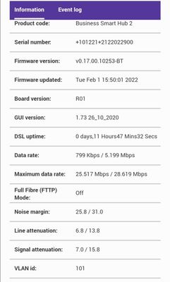

My wifi connection is horrible, it takes forever to download anything and i cant seem to do any work at all, things keep lagging and just stopping.
I have no idea how to fix it, help.

You either keep rebooting your HomeHub on a very,very regular basis or you've got a terribly noisy line which is impacting your connection speeds. Wifi isn't the problem it's just how you see the bad connection you have.
Try a quiet line test by dialling 17070 , option 2 preferably with a corded phone and if there's any noise report it as a line fault.
From your stats you see that the noise margin is 25+ on up & downstreams. This should be in the region of 6 for a good connection.
If you have  business broadband you should use the forum that Keith has suggested and with a business line you do get priority service.

If you have noise on the phone when you ring 17070 option 2 then it is a line problem and needs an engineer to fix.
The reported noise margin from the stats you posted would indicate that to be the most likely problem.

Because broadband will work very slowly with only one wire connected but you won't get dial tone. A quick check to identify a disconnected wire.

If you have dial tone then both wires must be connected. Did you try the quiet line test? I suspect your line will be very noisy (probably due to a corroded joint/wire somewhere) and the source of the problem.
