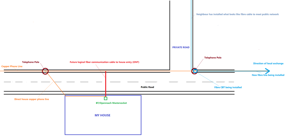

When a CBT is installed it’s size ( 4,8 or 12 port ) is determined by survey and the number of properties it can service, typically it’s the same as the copper network, so if your pole ( copper network ) had 5 properties connected ( or could potentially be connected ) then an 8 port CBT is provided, there is no reason why your address would be overlooked.
I guess this is the concern, that my property has not been included in the survey and a CBT with only say, 4 ports is installed.  I would imagine it would not be an easy or quickly addressed fix to change up a CBT to accommodate more ports?
I should clarify, as per my OP diagram, the pole that has my copper extending overhead isn't getting CBTs installed at it.  Its the slightly further away pole but still up/downstream of it.
I've updated my OP diagram based on all the advice on this thread.....

Just noticed, I will remove the logical fibre connection now that I know the cables dont just tee off fibre lines and must come from a CBT/junction box.

Every answer to your OP is pure speculation/conjecture. You don't need a CBT on your pole as a connection can be run from the CBT on the next pole to yourd and then follow your existing copper connection if you are so close to the road.
Its answers like this that have made this thread very valuable to me, and potentially future onlookers.  I agree some answers are guesswork but others have addressed my concerns/queries quite well.

I'd use the word concern not paranoia because I've read of so many instances where houses have been left out of the plans and CBT's have not been given enough ports to accommodate all the nearby properties.  The idea of being left with 4mbps internet while my neighbours, who are much further away from the network/CBT can get full fibre, I feel is worth voicing a concern over.
If you're referring to the outcome of me voicing all this, and it wont come to anything, I was always just looking for more information about how properties are added to the network, can they be missed, what happens when some ppl are notified and others aren't, do OR do private side installations, can I employ a private contractor to connect me to a CBT if I've not been included by OR etc....A lot of this information is not conjecture and assuming it comes from a reliable source, its important for how I plan my home network and future correspondence with OR if I need to plead me case.

Openreach do not do private installations and you categorically can't get a contractor to provide the connection. The only thing that is possible is to get a contractor to do is to dig a trench and supply ducting for Openreach to use. This is not appropriate in your case.
This is useful thank you.  So you're saying OR won't carry out any installations within private curtilage?  Even if the fibre needs to follow the old copper line?
Sounds like my neighbours are installing their own duct then but as per my above message, that begs the question who installs the fibre inside their duct from the public boundary to their property, especially if we're talking a few hundred yards.
But like you said, shouldnt affect my property as theres only 2m of private land between my house wall and the public road.
I guess the reason I'm asking about private contracts is in the scenario that OR do not install enough ports on the CBT to include my property, can I arrange an expansion or an additional CBT to be installed so I can get FTTP.  But think you've answered that.

No, I'm saying you can't employ Openreach privately to provide your connection unless you opt for fttpod which will cost you tens of thousands of pounds.
If your property is within Openreaches plans, they will provide the connection.
I'm with you now cheers.  So it all comes down to whether my property was included in the rollout plan or not.  If not, that will suck tremendously being within 6-7m of a CBT and seeing all my neighbours with kick **bleep** internet speeds!
Time will tell I guess!  And hopefully if I make enough noise, they might upgrade the CBT or something.

openreach will know how many phone lines are currently connected to the pole and active so they will fit CBT accordingly.  In my own area not all poles have CBT but fibre connection run from the CBT to the 'blank' pole and then to the property just following the existing copper cable.
I expect your fibre connection to do the same
