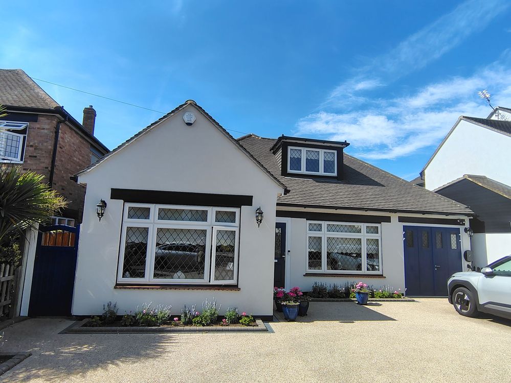

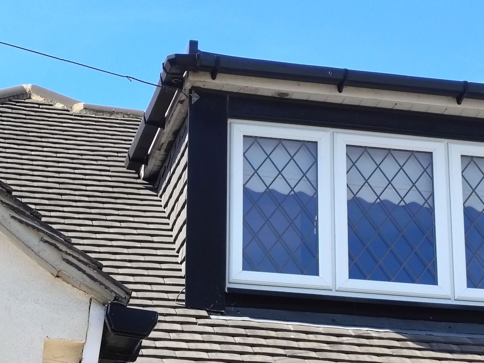

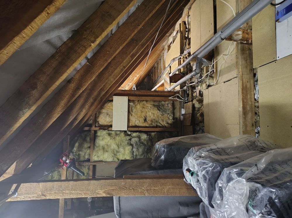

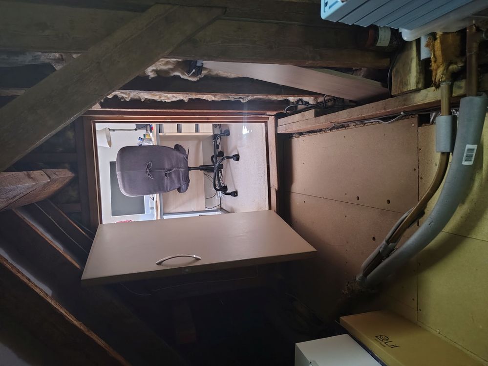

I have attached 4 photos: -
  1. Front of chalet bungalow,
  2. Close up of the front dormer window of the chalet bungalow. The existing cable from the telegraph pole is currently held on the fascia at the top left corner, and passes into the loft near the fascia at the bottom left corner
  3. Small door into the upstairs study, and its stud wall taken from the loft side,
  4. Stud wall of the front dormer room of the chalet bungalow in the loft showing a board I have fixed to it on which the CSP could be fixed.
Subsequent to downloading these 4 photos I am now thinking the Openreach sub-contractor may be happier to do the work if the new fibre-optic cable from the telegraph pole is attached outside to the top of the front gable end wall rather than the front dormer (see the attached photos). The fibre-optic cable could then be attached to the outside of the front gable end wall below the gable overhangs and just below the soffits along the side brick faced wall on the left of the chalet bungalow and terminated on a CSP outside at low level near to the side dormer window of the upstairs study which is my preferred location for the ONT. From the CSP the internal fibre-optic cable could then return up the side wall and either passed under a tile of the main roof to the loft (or passed through a small hole drilled in the soffit to the loft. It would then only be a short distance for this cable to pass through a stud wall in the loft to the study. Are there likely to be any problems with this?

As stated , no one can guarantee anything , its up to the installer, you may claim what you want is reasonable but its not your call   , you say a small door , if that’s a hatch rather than a regular sized door you should presume the installer will not enter via that into the loft  , and if they do it’s a bonus .
You obviously could have the ONT in a place that isn’t likely to be refused , so ground floor ,so the route is  cable from pole to property , down wall to low level , CSP fitted externally and inside out cable into ground floor location for the ONT , this is a standard typical installation, you then run your own Ethernet cable from here into the loft if that’s  where you require the router .
TBH you already been advised by an installer on the first visit  that they won’t enter the loft space , you should either have a second option you will accept or don’t reorder as that just wastes everyone’s time including your own
