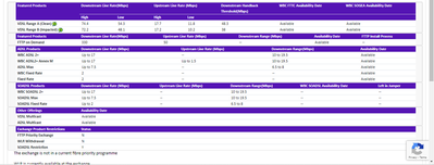

here is some background information. last year i was with EE broadband and we had a fault which took 4 goes to fix. the problem was a faulty pair of wires and we were swapped to a different pair from which point the speed dropped from 55-72 to 30mbps and stayed there ever since. the exchange is about 350 meters away.
Last month i swapped to BT as they were offering the higher speed of 55-72 but upon swapping i still only get 30mpbs on fibre 2 package.  when the email came through it says maximum speed of 33mbps but when i rang first off to sign up the person i spoke to said the download speed would be 55-72mbps?.
i have since phoned BT and they contacted open reach to find out why the speed is at 30 while all the other houses in my estate get 55-72mbps. The person i spoke to seemed to think something wasn't right but didn't know what it was. i have had no reply from open reach since 11/10/22
having read some posts on this community i think i may be on the wrong profile?. here is the log from the modem etc.
thanks for any help in advance.

distance from exchange is immaterial it is distance from street cabinet that counts.  if you were on wrong package that would not affect attainable speed and yours only shows 44mb.
Have you checked your phone line for noise as long as you are not on digital voice can you dial 17070 option 2 it should be silent and best with corded phone
