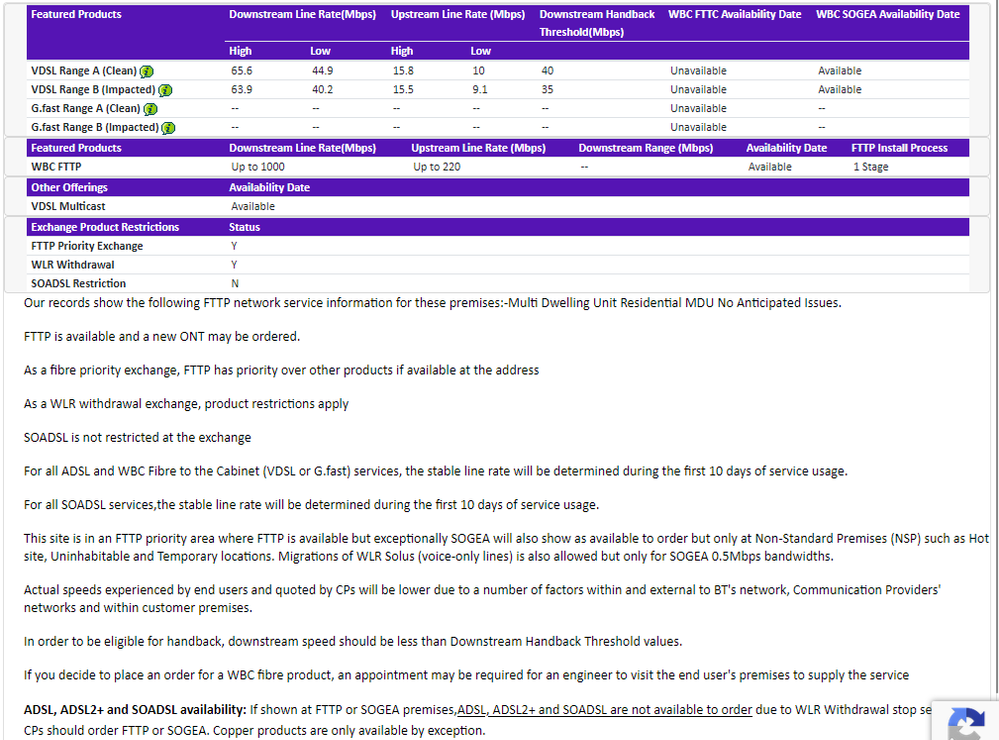

Interesting.   Yes, it's not a "tower block" and it's not a conversion.  It's just six flats built ~ 2005, two down, three up.  I'm not sure if there's a line from a telegraph pole.  I'll have to check that.
I put my address into the checker but I don't know what most of this means:
Availability Checker ResultAvailability Checker Result

As can be seen , MDU , no anticipated issues , it also shows 1 stage install process …so Openreach are happy that service to the flat should be fairly simple, if the construction were from 2005 , it’s likely to be underground service but there could be variations on the way the copper pair was provided, generally FTTP copies the method , there may be ( for  example ) there were a duct to a central point , and a riser to the first floor , or could be duct to an external wall  and the ground floor flat and the flat above could be served from that point ( this potentially may need the ground floor flat having a cable on their wall leading upto the first floor , but you would expect instead of ‘no anticipated issues’ the note would be ‘ potential wayleave required’ ….but whatever the exact method it’s not really your problem, you order it , Openreach deal with it

You might want to check the availability for your neighbouring flats as it will show if they already have an FTTP ONT installed - if they do you could ask them about the install process.
