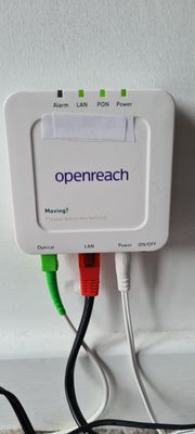

Check the LED's on the ONT (the white box that the hub is cabled to)
LOS should be out with not a single flicker
PON should be illuminated with not a single flicker
5,126 Views
Message 8 of 17
Re: BT Halo 3+ installation problem
Go to solution
Thanks. PON is solid yellow. There is no LOS?

Message 9 of 17
Go to solution
There are different versions of the ONT but as far as I'm aware they all have a LOS indicator.
Yellow doesn't sound right at all, I would expect PON to be green.
Check here and see which ONT is yours.
What do the lights on the Openreach modem mean? | BT Help
5,077 Views
Message 10 of 17
Go to solution
 Maybe green rather than yellow (my eyes!) But no LOS?
