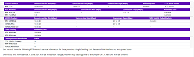

This is mine,  still shows 1000 however eci limits it to 330, i get offered faster every renewal until i tell them i cant as on eci and they check. The mailings are generic and i get them all the time, however on mybt, it knows I'm limited and doesn't offer greater than 330/50.

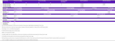

@yorkspark
Thanks for that, here's mine.  Looks a little different in places, anything pop out?
