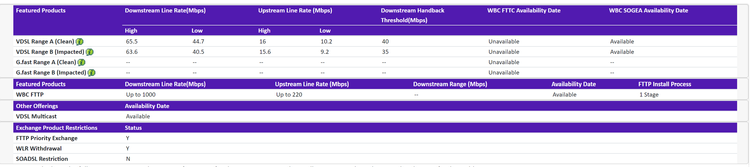

Here's the result using the address checker

It says FTTP priority exchange, so that is most likely the reason, you are being given FTTP.
