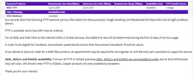

Below is a copy of what the btwholesales address checker says:
I totally understand Openreach is phasing out copper lines and it will have to be FTTP which is the service I want.  As I am working from home, I would like to be able to at least sign up to a service to use the Connect Hub as a start but that's still not possible as my orders get cancelled. The main thing is, what do I need to do to move this in the right direction so I my address can be registered for a service and to get Openreach to send the right engineers to connect the fibre into the property?

Its also possible that only copper cables were run to the communal area. Openreach are not phasing out copper services, so its possible that only VDSL connections which are over copper, are available.
Apartments would not normally be fed overhead, which is why it says there is a line of sight problem.

from your post your live in an apartment block but the checker you posted for the address refers to a single dwelling with overhead feed so obviously address not recorded correctly
if you still need openreach to connect the actual apartment block to external fibre then that is up to developer to liaise with openreach.  as @Keith_Beddoe  openreach will not install fibre connection to your apartment until you can place an order and you cannot place an order until developer gets openreach to complete installation to apartment block

The chances are, that there is no fibre infrastructure, and the records are indicating a nearby single residential property.
