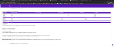

Thanks of reply.
Here are my results:
This one is showing that FTTP is not available, even though I am using it right now

The UPRN check shows that an ONT is fitted ( which is correct as you have FTTP ) but the address checker doesn’t , so there is apparently some mismatch between them , if you use a UPRN checker does the UPRN you posted identify the correct property, and is your address identical to what the Royal Mail keeps for your address ?.
If BT are your provider you could ask for a ORDI ( Openreach data integrity ) check , so that any error or omission between what OR have and your actual postal address can be corrected.
