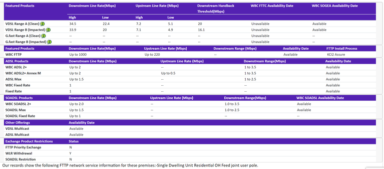

they originally surveyed and said everything was ok, otherwise neither of us would have proceeded, even on the day of connection back in April when their engineer attended and installed everything internally in y house stating they would be back in a couple of days to completed...things have not really progressed from there until we saw on the council website that BT had roadworks to my pole due at the end of February '24.
Then the unespected auto cease cancellation and now the roadworks have disappeared from the council website - feels like we are back at square one with no end in sight.
Vut thank for the advice Iniltous, snip fro  the website if you are able to decipher?

Your address is KCI2 Assure, so a two stage install ( preparatory work done in advance on stage one  ) and OH ( overhead feed ) via a joint user pole , so a ‘power’ pole ( one belonging to the power company , the  DNO distribution network operator ) used  to deliver the overhead ‘wire’ to your property.
There are understandably strict safety and usage rules about poles that belong to the DNO , they are primarily  to distribute the electricity supply,  a secondary use is that Openreach can also obtain a licence to attach their own cables to them , the separation between power and telecom etc need to be observed, in these circumstances, it can only really be a guess to what the issue may be , but OR cannot just provide a new CBT on a power pole , even if it’s got a copper pair DP on it , permission is needed for the new equipment before it can be fitted to a DNO pole .
I would imagine because your FTTP service is dependent on a third party ( the DNO ) if ( for example ) they have their own plans regarding that DNO pole , they could refuse any further attachments and the order then cannot proceed , perhaps in this circumstance , the Openreach policy may be to cancel the order before the second visit ( the second visit is the contractual date )  , so as you say , perhaps to remove the penalty for late delivery, by cancelling the ISP order before the contractual date arrives.
You have a reasonable argument that you  ordered in good faith ,  but the counter argument is  that if the DNO say ‘No’ , these are matters beyond Openreach’s control.
Irrespective of the issues , you should have been better advised, but that would be via your ISP , but beyond that it’s impossible for anyone on this forum to really second guess what the actual problem is , suffice to say power poles are  not a very common problem overall , but in some rural locations they can be ,  but that is of no consolation  to you, all you can do is ask BT to enquire with OR .
