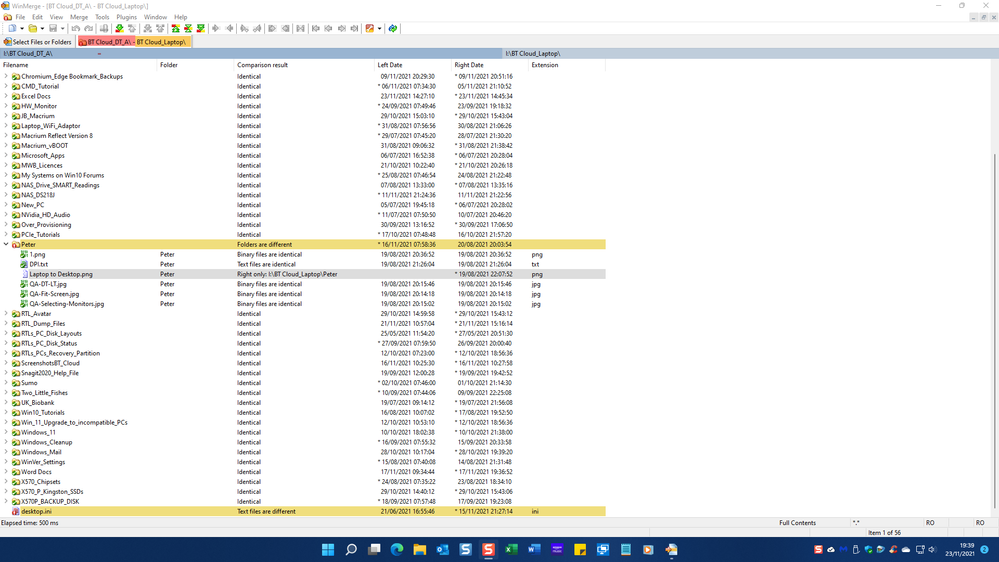

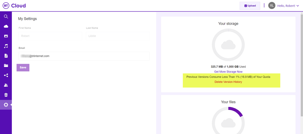

@henryfm  @PaddyB    Well I have been nosing around looking for the "old files"  and have a query about BT Cloud.  The highlighted part is what interests me.
It says Previous Versions.  Could that be files or does it mean previous versions of BT Cloud? I did do an in-place update from 21.4.10 to 21.8.9. If it is Files, then I don't know where it's keeping them. Nothing in the Dustbin or anywhere else that I can see. If nobody knows then what I'll do is delete  it.  Then repeat the exercise again to see if it builds up when I save files. Could be the "old one" goes there--don't know.

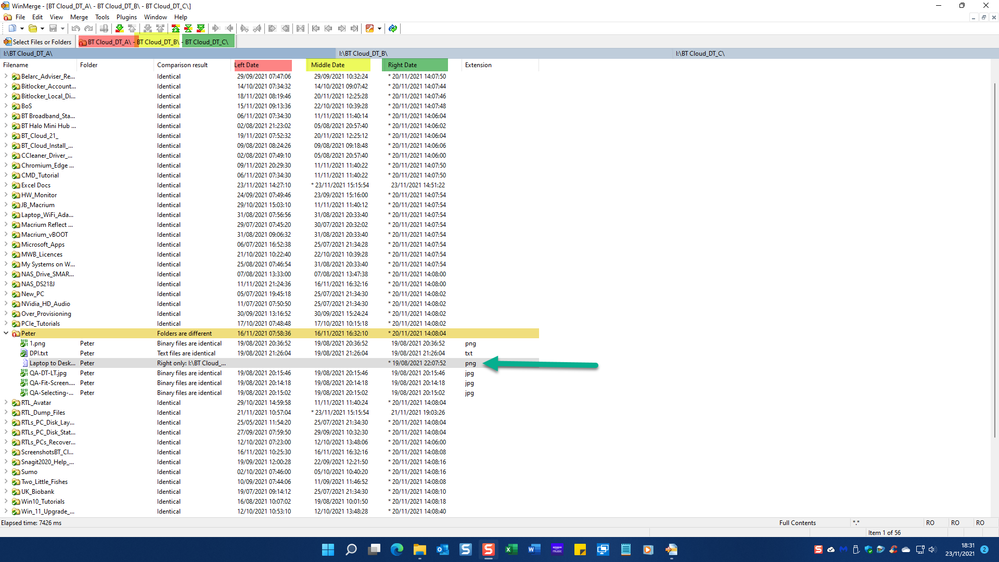

Next thing I've been doing is comparing the BT Cloud Folder on my DT A, DT B, DT C and Laptop. I copied the Folder from each one to an external Disk to do the comparison. It only throws up one error. A .png file is missing on DT A and DT B from folder Peter. It is on the Laptop and DT C and in the Cloud. Only thing I can think of there is that DT's A and B are on Windows 11 but don't know how that would affect it.  The time stamps for some folders are different but the PC's are not all on at the same time so that could account for that. It does say though that the folders are identical!!
Compare DT A to B and C.
Compare DT A to B and CCompare DT A to B and C
Compare DT A to Laptop.
Compare  DT A to LaptopCompare DT A to Laptop
You can ignore the Desktop.ini  error at the bottom. It's because on the Laptop my User Name  is rtl43  whereas on the Desktops it is RTL.

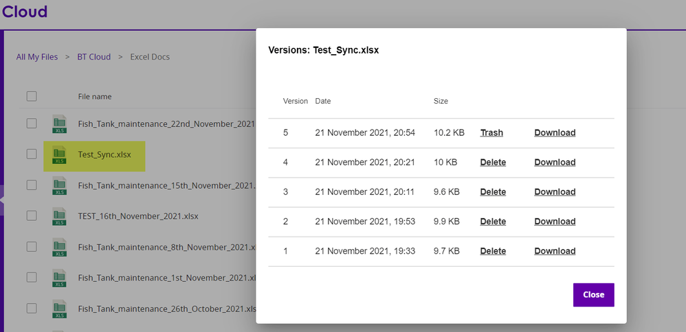

In the BT Cloud web repository, find your Test_Sync file. Hover the mouse pointer over the file name. Three purple dots appear to the right - click on them and you get a menu. Click on Versions - you should see the versions sequentially uploaded during your tests. I think the time shown corresponds to the time at which they were uploaded to BT Cloud, not the creation time. (This is what I alluded to in a previous posting). This is where you can find older versions of files if you use Save rather than Save As, enabling you to go back to an earlier version if clumsy fingers mess up a file. Probably not worth deleting these previous versions as you have plenty of headroom.

@henryfm @PaddyB  Thanks for that.
They are there in the Cloud.

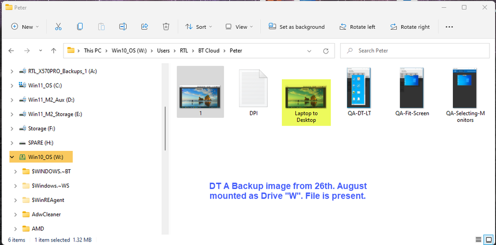

Earlier I mounted a backup image of DT A from 26th. August as Drive W.  The file is present in it.  So somehow between then and now it has "disappeared" and not being download again. Can't check further backups at the moment as the backup disk gets locked @ 08:25 while my NAS powers up to do its backups.

File present 26th. August.File present 26th. August.

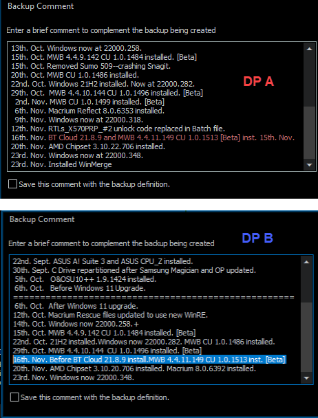

@PaddyB @henryfm   O.K. I haven't re-installed BT Cloud on DPB yet.  I went back through my backups and found that the file was present in DP A on the morning of the 15th. Nov and was present on DP B in a backup from 11th. Nov. ( I don't have regular backups scheduled on DP B--DP A is my main one.) I do have a backup for DP B on the 16th. and the file is missing as is the file on DP A.
In Post #3 I stated that I was going to install 21.8.9 to DP A but found it was already on---must have happened when I powered up on the Monday to do the Excel file. This is where the file has disappeared I reckon. It could be the fact that Malwarebytes was updating at the same time as I have the option to automatically install updates set--or me doing the Excel file unaware that BT Cloud was updating. I had no notification like I got for 21.4.10.
So when I then installed it to DP B later, it also got screwed up.  Why they haven't corrected themselves--I don't know.
In Post #4 dated the 19th. when I brought my DP C  out of retirement, I installed 21.8.9 and it is correct.
Here are the comments I make in my backup program:-
CommentsComments
