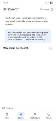

The turning off the wifi and using the data on my device i don't have any restrictions of any websites as soon as I turn my WiFi back on it will block 18+ sites ect the bt app wont turn off web protect and parental controls or even turn them on

How do you know it is Web Protect blocking the sites?
Has Web Protect informed you that it has blocked the sites?
Do you have any browser addons or any antivirus/ anti malware installed that could be blocking the sites?

At top of the page it will say safe search is locked with this message when i turn the WiFi off I can change the settings and when the WiFi is on it will be locked

That's Google's Safe Search, built into the Google browser, it has nothing to do with the BT app/web setting!!!!

As has been pointed out Googles  "Safe Search" is not the named product  "BT WebProtect" and as such it has nothing to do with BT.
If you do an Internet search of "Safe Search" you will find out how to turn it on and off.

I understand what your saying i have googled it ive been through goggle settings ect for a while now
I only can turn it off when my device isn't connected to the WiFi
As soon as I connect my device to the WiFi even when I turned it off through 5g ect it will lock safesearch and I cant change it and it gives me that message what I posted above
