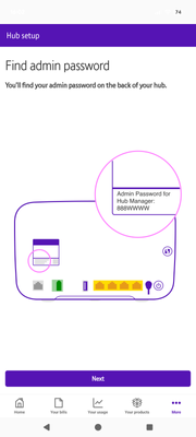

Thanks for looking @Peter_W  - I think it's supposed to be just during hub set up that you need to add the admin password. I can do things like speed test and restart the router, but when I try to go to the "your WiFi network" it is asking for the admin password "on the back of the hub". 
I've attached a screenshot - after this page I can add the password but it says it's incorrect.

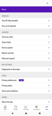

I'm trying to access the "your WiFi network" menu where you can control WiFi access for devices (second option on this menu)
From there I get the screen asking for the admin password, as shown on my other post.

Your previous post shows the page for setting up and connecting to the hub.  Once connected you should not need to use the admin password and that page will not be offered again.
