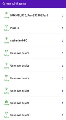

I used this function of the BT app everyday for controlling my kids screen time through having schedules set up and instantly restricting WiFi access for bad behaviour, but for the past month this function has not been working. Nearly all devices now appear as 'unknown device' or a random code which it lets me rename but then instantly forgets! It's lost all it's 'group devices' and schedule information, and also instantly forget any new ones I create.
I have reset my hub, uninstalled and reinstalled the app but this hasn't helped. Has anyone had a similar issue? And were you able to resolve it?

@Keith_Beddoe  I maybe haven't described the problem clearly. I've attached some screenshots of what I see when I go into 'control wi-fi access'. I try to rename the 2nd device in the screenshot to something useful, which it lets me do for a short while then it reverts back to what you see here. The same goes for adding devices to the group's, it lets me do it but reverts to having no devices in the group's, and also the same for trying to 'pause WiFi access' for individual devices. The app worked perfectly well for years and was very useful to me as a parent, so I really hope there's a solution

I do not use a BT Home Hub, but reading what other people have said, I would not rely on what devices are showing, as those unknown devices that are showing connected, are probably not connected, and are just the same Apple device, before you disabled private addressing, and the ARP table is still holding the entry.
