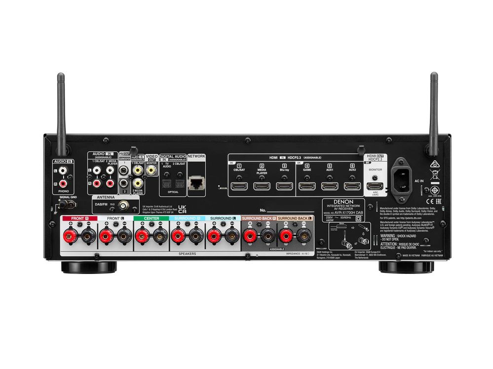

Yeah I get that but youre not using eARC anyway.
For example it would be for if you had your Bluray player and EE TV box connected to different HDMI sources on the TV directly, then the audio for those sources would pass back down the HDMI connected to the eARC ports and out the receiver's speakers.
In your case, you dont need to...your AVR likely will only have one output of course and it will be labelled eARC because it supports it:AVR-X1700HDAB_back.jpg
This is the back of my AVR, under the white 'Monitor' port in small writing you can see 'eARC', its just to signify that port supports it, but its irrelevant as its not used and I dont need to worry about what port on the TV it connects to.
Dont get me wrong, I am not saying you have connected things up wrong, I just mean I dont think you are actually using eARC at all and might as well disable it.
Anyway, good news, hopefully devs get it fixed.
