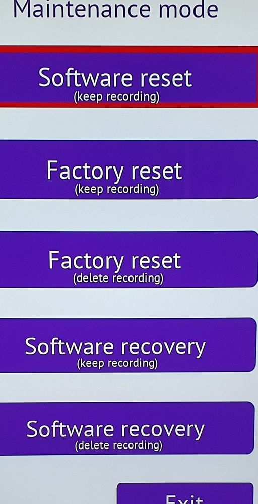

Hi,
Been away for a few days - But Still the BT TV box not working.
I have tried to reset as per the instructions but from the Screen which says "Maintenance Mode" and a list of reset boxes - the top one says Software Reset and the second Hardware Reset etc.
However, I cannot navigate or choose any of the options from my remote - no button on the remote will move or select any of options.
I did get a BT SMS while I was away informing me that my box required important software update and this would be done overnight and to leave my BT TV box plugged in and connected to the my broadband.  Obviously, being away I could not do this.
If I simply switch on the BT TV Box the screen  appears in setup mode and the screen says "check that your box is connected to your aerial and Lets get started".  Unfortunately, I cannot select the OK button because, again, my remote controller does not control anything on screen and the usual blue light which lights up whenever a button is pressed on the remote does not show.
So I still have a problem and don't know what to do to solve the problem.
Any suggestions most welcome - John

@design4p
Just to clarify , when the instructions for a maintenance mode reset refer to arrow buttons it's those on the box itself NOT the remote.

@design4p
I had a similar problem with my BT Pro TV box remote and had to re-pair the remote with the box by doing a reset.
https://www.bt.com/help/tv/fix-a-problem/remote/which-remote-do-you-have/resetting-your-remote-contr...

Message 6 of 9
Re: My BT TV Box has stopped working
Go to solution
@TimCurtis  The TV Box Pro doesn’t have the range of buttons that previous models have so the maintenance mode  [MM) instructions are different.
Unfortunately the current instructions don’t appear to cover the navigation and selection  of the MM options when they appear.

Hello BillyM,
Brilliant - A Big Thank You -
The re-pairing of the remote worked and this allowed me to go through a software upgrade.
All working well.
Regards John
