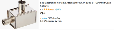

It is entirely possible that the signal strength is too high and overloads the tuners causing pixelation and dropping the signal strength right down. When it's OK what strength & quality figures are you seeing?
If it is too high then a variable attenuator fitted between the aerial plug & the box's aerial input socket and adjusted to around 85% should cure your problem.

It’s the BT box pro. The signal strength is showing as 90% and signal quality is 100% is this high? I purchased an attenuator but my husband says it doesn’t fit the box. Is there a particular type for that box I need to purchase?

This is typical of what you want:-
I'm not sure with the Pro box what strength is acceptable but with the earlier boxes some would find 90% just on the high side. Obviously 100% for quality is spot-on.
