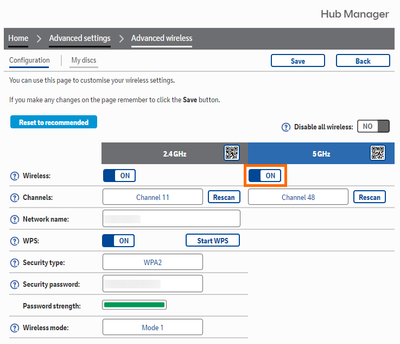

Hi, to check and turn on the settings, you need to go to the Hub Manager page , select Wireless, then click "Change Settings" . We can remotely reset it if you would prefer - just drop me a Direct Message and I'll get something set up.
To get to the Hub Manager, you can use a browser e.g. Chrome, Safari or Edge (depending on your PC) and enter  192.168.1.254 into the address bar and pressing Enter to display the home page.
You can either press "Reset to recommended" or simply ensure both channels are "On" and set to Smart mode.
Note that changing settings need to be confirmed using the Hub password which you will find on the removable card in at the back of the hub together with the Wifi password (which is different!)
any problems let me know and we'll help if needed.
