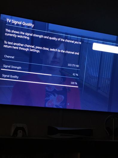

Hello
I have a huge outdoor aerial in my attic that someone installed for me, never even questioned it before until earlier today I was watching ITV HD and the picture broke up a few times. Checked signal quality on BT Pro box and the Signal Quality was a solid 100% but the Signal Strength kept fluctuating between 62%-78%, is this normal and is 62% going towards the low side?
Perhaps it was just a blip, I know even Sky's picture can break up occassionally via Satellight so maybe its nothing but it just got me wondering about my aerial and the signal strength. How would you go about improving the strength so that it doesnt fluctuate as much and remains on the higher side?

Re the loft antenna, with digital I think you should not have a problem the quality/strength you are getting although it is very tuner specific.
Strength will fluctuate based on atmospheric conditions. An antenna in the loft will always be a bit compromised as the signal has the roofing to get through.
I would get a local antenna person around to check your set up and advise.
BTW have you retuned recently? Might be worth doing that first.

Signal Quality refers to error correction status with it being 100% means the signal is being received and there is no error correction being applied.
Signal Strength is as it sounds the strength of the signal of the relevant MUX received from the transmitter. You typically do not wish any higher than 75% as receiving too much signal can cause issues too.
Being a digital signal you also occasionality have a few moments of error this does not necessarily mean it is because of your antenna it could be an issue further up stream of the transmitter etc.

@DStruct you're signal quality is potentially too high and causing issues with pixelation. I'd suggest trying an adjustable attenuator that are a available for a couple of quid from Amazon etc.  E4 won't be HD either and the picture quality from OTT Freeview will be a lot worse than the IP delivered version.

Can't agree with your comment about Signal Quality.
Quality should be 100% or thereabouts and with the T2/T4 boxes Signal Strength should be in the 80-90% range in my experience, any higher can cause pixelation because of overload.
As for the Pro boxes I've no idea as the tuners used on them are totally different to the T2/T4 units.
It's a strange fact that if the Strength is too high that it can so overload the tuners  that the Strength figure drops and fluctuates, sometimes dramatically, and in these circumstances a variable attenuator can provide the solution.
