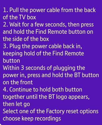

I have carried out a full factory reset about 22 hours ago and so far no further issues, I have now set my frame rate matching to off.
When you say live pause and then play from pause, do you not fast forward again to catch up?

Expectingtofly have you tried a factory reset? not saying it fixes the problem but that's a full 24 hours since I did one, and no issues so far, and it was pretty regular with mine.
