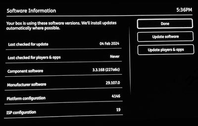

The recent Youview announcement states that internet features will no longer work for the T1000 models.  https://support.youview.com/end-of-support-for-humax-t1000/
Does this include resets, or for units that do not have the latest T10X0 software the ability to update?
I.e. Will a T10X0 with latest component software for the T10X0 be able to reset?
I.e. Will a T10X0 with component software 1.7.4 be able to update? There are 3 "New" T10X0 units currently for sale on a well known auction website.

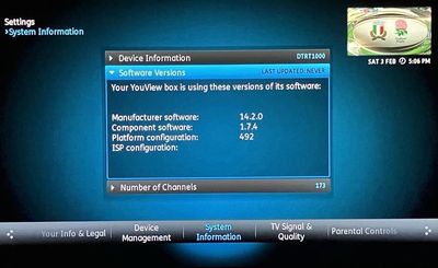

@Midnight_Voice  Thanks for replying, but the first image was taken from a T1000 that had even older component software and was updated to its current version of 3.3.168 after 2017 when it was connected to the internet. I think that was circa 2021.
If I connect the T1000 that has 1.7.4 to the internet, before 28th February, are you saying that it won't update?  I suspect it would update until 28th February, on the basis that the other box updated, even if that was 2 or 3 years ago.  My question is of someone who has not the latest version of the T1000 component software connects to the internet after 28th February whether or not it would update.
In the mean time boxes that are not connected to the internet and have pre 2017 software can be reset just fine and that it includes the box room which the second image was taken. I reset the box from the youview menu at the weekend.
