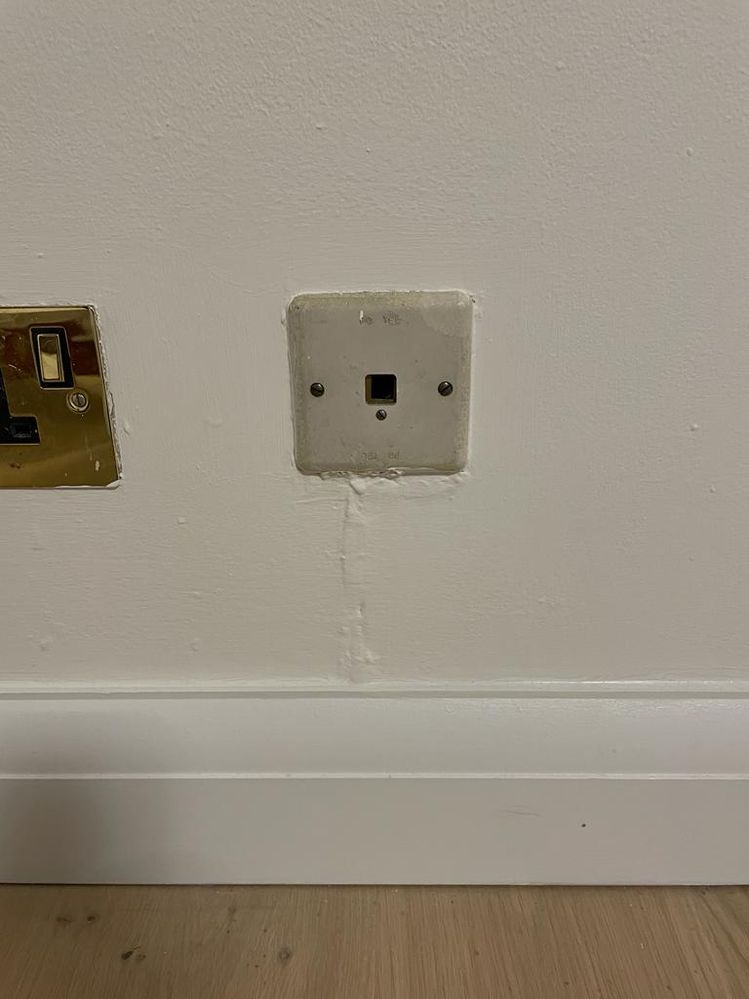

Can anyone identify this old socket
Moved into new home and cannot find a standard BT point to plug my phone/router into. The attached photo shows a socket which says "Tel" on it.
Can anyone suggest what I should do? Can this be used as a master socket and if so, what kind of adapter would I need? Alternatively, do I need to have Openreach attend to install a proper line?

That ‘socket’  is ancient and previously had a hard wired phone connected ,one  like you see in 70’s TV shows , with a rotary dial , ( search BT 746 telephone if sufficiently interested )  , they don’t have a cord with a ‘plug’  on , these were normally replaced with a ( relatively) modern PST ( plug and socket) type socket ,   and those have been in existence since the early 1980’s, that gives an idea of how old that is , it’s typical of what was provided in 1960’s and 1970’s housing , supplied and fitted by the developer to give a ‘finished’ look to the wall .
….if the  address has had a recent service from Openreach it’s unlikely to have been via that socket , but it’s possible if that address has been with ‘cable’ for the last 30 years , there may never have been a more modern Openreach service point installed, or there was another PST socket somewhere else in the building, possibly removed by a previous occupant if it were surface mounted.
As far as what you should do , if you want BT service, order it , chances are there will not have been any service recent enough to try and remotely start service, so a full installation would be needed, and a new socket provided, it may even be FTTP is available and in that case , even if that were a more modern socket , it still wouldn’t be used as its for a copper pair service, and you would be getting  an ONT not a master socket .
