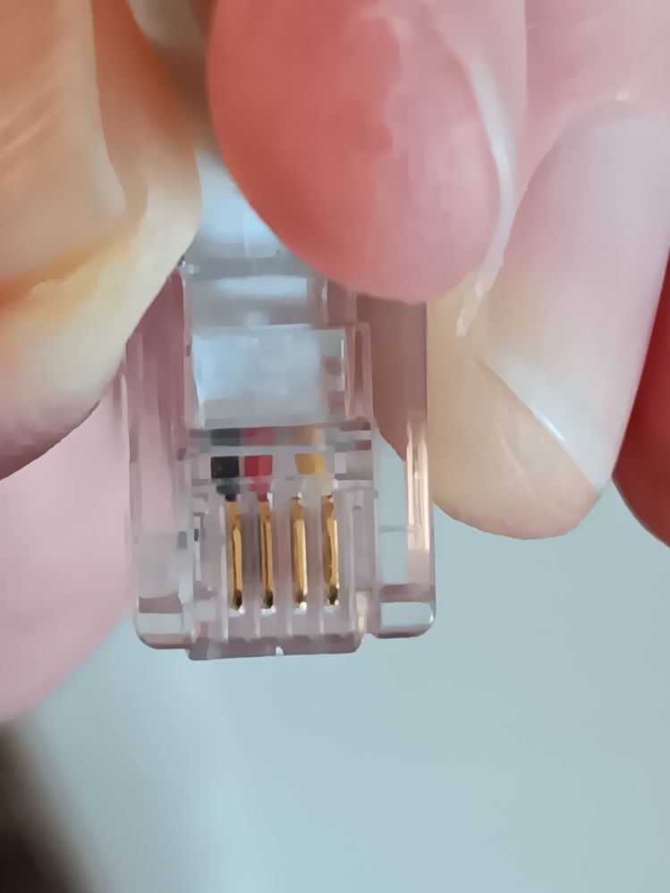

I had a look this morning and it was still a bit confusing. I looked at the end that goes into the phone and it had a black cable to pin 2, a red one to 3 and a yellow one to 5. Is that straight rather than crossover or have I a really odd old cable? Sorry if the photo ends up too large.
Out of interest I looked at the other phone I tried to plug in, but it was impossible to see which pins were connected, although it looked like the middle 4 of the BT end were all copper instead of just 2.20250831_100723.jpg

You don't need RJ12 as only pins 2 & 5 or 3 & 4 are used on the RJ11. You need to ascertain what you have, using the link I provided  or order one of each straight & crossover. Ordering blind has only a 50:50 chance of getting the right one.

You can't tell anything by looking at one end, You've identified the colours on the BT431A, so where do those colours connect in the RJ11

From what I can see, the end that goes into the green socket on the router has the yellow cable to 2, red to 4 and black to 5. So what does that mean in combination with the other end I posted above?

Your pic has only just been approved, so we can now see that the RJ11 connections also go to 2 & 5. Therefore if that is a pic of the original cable you need "straight". If that is the replacement cable that doesn't work, the you probably need "crossover".
With all due respect to @licquorice, the variants of RJ are a bit of a red herring, as they're essentially the same connector with different numbers of physical pins. Just stick with RJ11.
